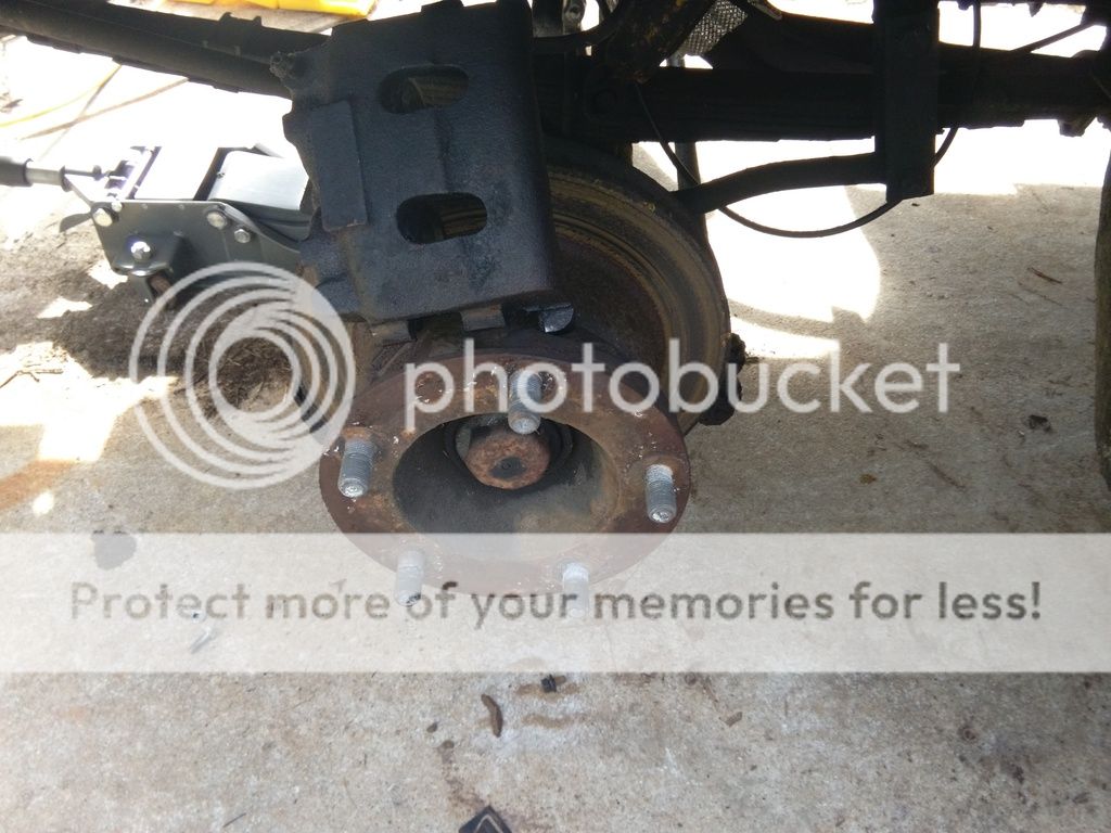

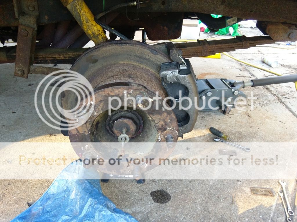

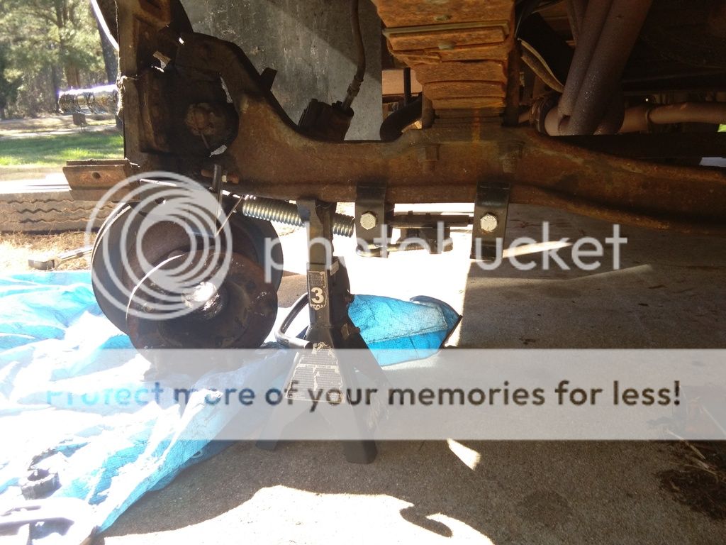

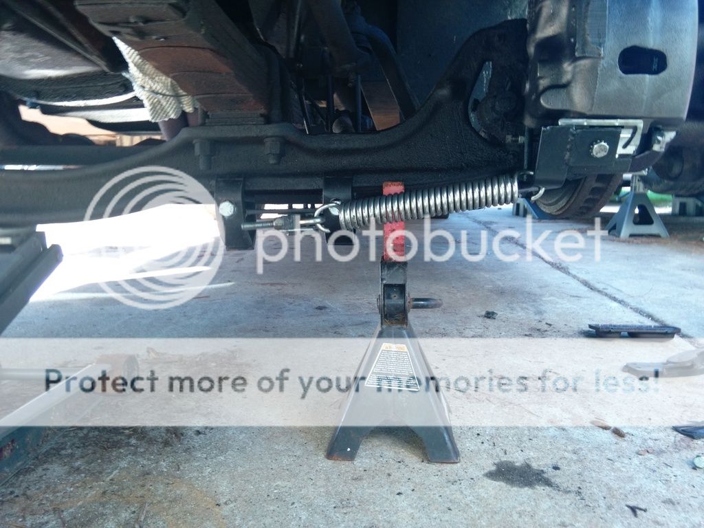

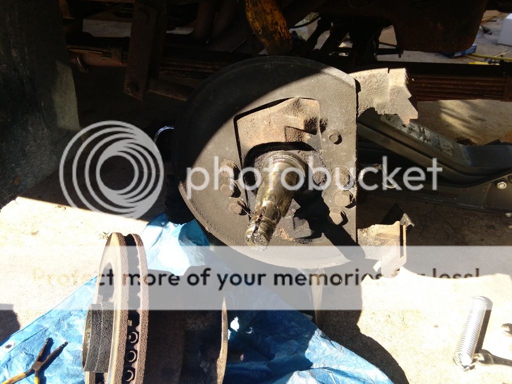

Just a few pics.\nLeft coming apart\nImage\nRight bearing slightly loose so pulled them out, cleaned and inspected, packed with new grease and put back in.\nImage\nSteer Safe on the left front\nImage\nPartially disassembled Steer Safe on right side\nImage\nRight side back together\nImage
